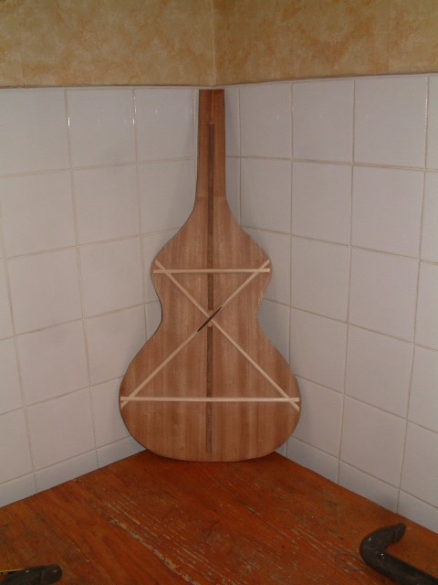

When you decided to raise your bridge height, did you add a bit more height to the bracing to compensate for the increased leverage of the higher bridge?
I kept my Weiss bridge as low as possible so I could lighten up the top braces a bit.
A lot of the original Weissenbornes had problems with top distortion, so I kind of re-invented the bracing. After 2 years, the top still looks very good, but I want to go higher on the next bridge. It'd be interesting to see how Weiss bracing is developing in the new "low mass is good" world.
The bracing on the GAL plans I used seemed very high mass & structurally ineffective. Is anyone else playing with the bracing on these great instruments?

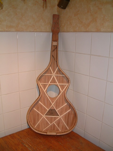

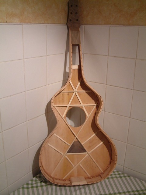

As you probably know I am a bit eccentric and not a traditionalist and approached building the Weisses as any of my other instruments. I used my usual 13' top brace radius and 10' back brace radiusing, Lutz spruce for the top and back braces (6-7mm wide by around 12-14mm at the highest capped X brace point), "triabolic" shaped - triangles and then tapered, narrow top X brace angle (about 78 degrees), sound hole re-enforcement plate, and "voicing" the top to give clear ringing sustain everywhere. On the back I did my normal X/ladder hybrid. My main focus was on the forward from soundhole area to counteract the string pull with no neck block and I evolved the interlocking X/ladder bracing here plus some criss-cross carbon fibre in the hollow neck area. Weight wise they are a little bit heavier than Todd's - about 3lb 9oz.
I didn't take many detailed pictures of the bracing but here's my Red Kite:
And Martha's slightly deeper bodied version:

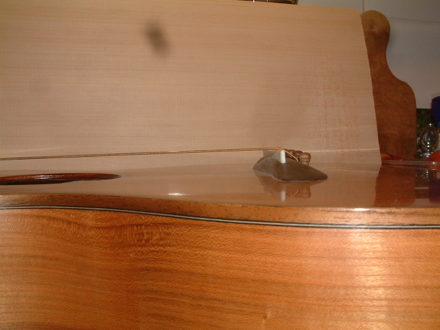

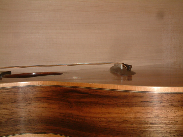

I just did some measurements tonight. On my Red Kite the strings are 5/16" above the fretboard at the nut and 5/8" above the soundboard at the bridge. Martha's is 1/32" higher at both points. Here are some pictures of the bridge geometry as of tonight (not very good ones I'm afraid). Mine is coming up to 9 months old and Martha's 7 months so it's early days but they seem fine and stable to me:

and Martha's:

I did bracing similar to Todd's on my first... My X was much more open to try bring out the bass response when tuned down to C. It seems to have worked well. The owner loves it & keeps it tuned in C most of the time.
I'm considering an X / lattice hybrid for the next one. I have built a few "flat top" zooks using this system & the tops are really stable & responsive while staying nice & light. Coupled with the Lutz top I'm hoping for a BIG sound, with lots of bass... And the stiffness needed to maintain its shape with a higher bridge/saddle.
